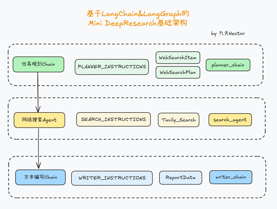

本项目是一个基于LangGraph框架构建的自主研究智能体,能够根据用户查询自动生成深度研究报告。通过三阶段流水线架构,实现从问题理解到报告生成的完整闭环。
项目结构

核心代码架构
1. 数据模型定义
  1. classWebSearchItem(BaseModel):
  2.     query:str
  3.     reason:strclassWebSearchPlan(BaseModel):
  4.     searches: List[WebSearchItem]classReportData(BaseModel):
  5.     short_summary:str
  6.     markdown_report:str
  7.     follow_up_questions: List[str]
2. 规划器(Planner)
  1. PLANNER_INSTRUCTIONS =("You are a helpful research assistant. Given a query, come up with 5-7 web searches ""to perform to best answer the query.""Return **ONLY valid JSON** that follows this schema:"'{"searches": [ {"query": "example", "reason": "why"} ]}')
  2. planner_chain =(
  3.     planner_prompt
  4.     | model.with_structured_output(WebSearchPlan, method="json_mode"))
3. 搜索代理(Search Agent)
  1. SEARCH_INSTRUCTIONS =("You are a research assistant. Given a search term, you search the web for that term and ""produce a concise summary of the results. The summary must 2-3 paragraphs and less than 300 ""words. Capture the main points. Write succinctly, no need to have complete sentences or good ""grammar. This will be consumed by someone synthesizing a report, so its vital you capture the ""essence and ignore any fluff. Do not include any additional commentary other than the summary ""itself.")
  2. search_tool = TavilySearch(max_results=5, topic="general")
  3. search_agent = create_react_agent(
  4.     model=model,
  5.     prompt=SEARCH_INSTRUCTIONS,
  6.     tools=[search_tool],)
4. 写作器(Writer)
  1. WRITER_PROMPT =("You are a senior researcher tasked with writing a cohesive report for a research query. ""You will be provided with the original query and some initial research.\n\n""① 先给出完整的大纲。\n""② 然后生成正式报告。\n""**写作要求**:\n""· 报告使用 Markdown 格式;\n""· 章节清晰,层次分明;\n""· markdown_report部分至少包含2000中文字符(注意需要用中文进行回复);\n""· 内容丰富,论据充分,可加入引用和数据,允许分段、添加引用、表格等;\n""· 最终仅返回 JSON:\n"'{"short_summary": "...", "markdown_report": "...", "follow_up_questions": ["..."]}')
  2. writer_chain = writer_prompt | model.with_structured_output(ReportData, method="json_mode")

运行流程
    输入:用户查询通过messages参数传入规划:LLM生成5-7个搜索计划搜索:串行执行每个搜索任务综合:整合所有搜索结果写作:生成结构化中文报告输出:返回包含摘要、正文、后续问题的JSON

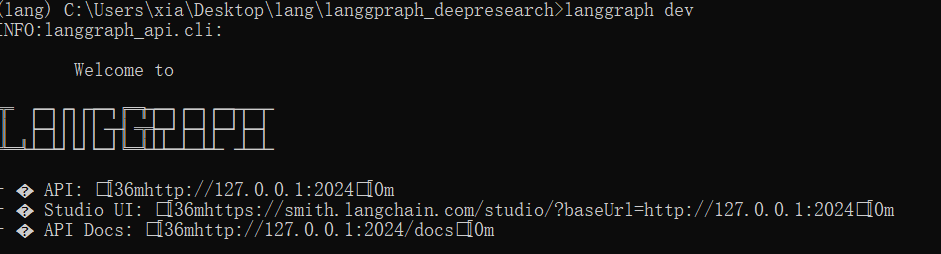

部署
项目部署大家参考这里:langgraph-cli快速完成项目部署
